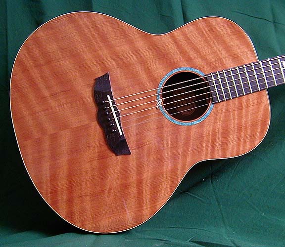

Here's a bigger picture of that guitar you mentioned, Dennis.

Thanks for the info, the encouragement, and the bigger photo. Yes, that is one beautiful top! I'm especially glad to hear that you feel that the results are great, because I'd hate to put forth the effort and then end up with a stunning, wall-hanging, guitar-shaped object.

Bob...it's funny that you mentioned black walnut, because the guitar in the picture I posted is also made with black walnut back and sides! That combination is killer.
